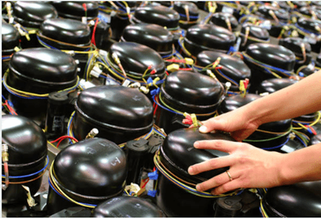

Figure 1: A lot of neatly arranged compressors.
