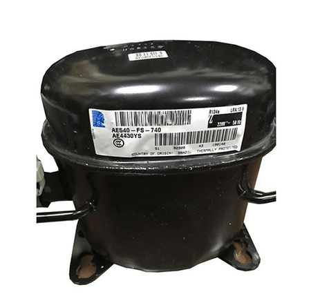

Tecumseh Compressor AE4430YS
Figure 1: A refrigeration compressor manufactured by Tecumseh.
