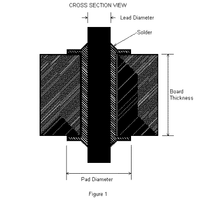

Figure 1
Vsp = (((Vpth + 2 x Vfillet ��� Vlead) / % metal content of solder paste by volume) x % paste release from stencil) ��� Vphole
Where the % paste release from the stencil may be greater than 100% for an off contact print.
Vsp Volume of solder paste required
Vpth Volume of plated through-hole (P x radius of plated through-hole2) x board thickness
Vlead Volume of lead:
a) round lead = (P x radius of component lead2) x (board thickness + (2 x fillet height)
b) square lead = (length lead x width lead) x (board thickness + ( 2 x fillets height))
Where fillet height = (diameter of solder pad ��� lead diameter)/2
Vfillet Volume of the solder fillets
The solder fillet volume is calculated by employing the Papus rule which states: The volume of solid body
formed by revolution equals the area of the surface multiplied by the length of the path of its center of gravity.
Volume fillet = 0.215r2 x (0.2234r + (lead diameter/2)) x 2P
Where r = (Diameter of solder pad ��� lead diameter)/2
Vphole Volume of solder in the plated hole. This volume will be dependent of the hole size and your printing process.
